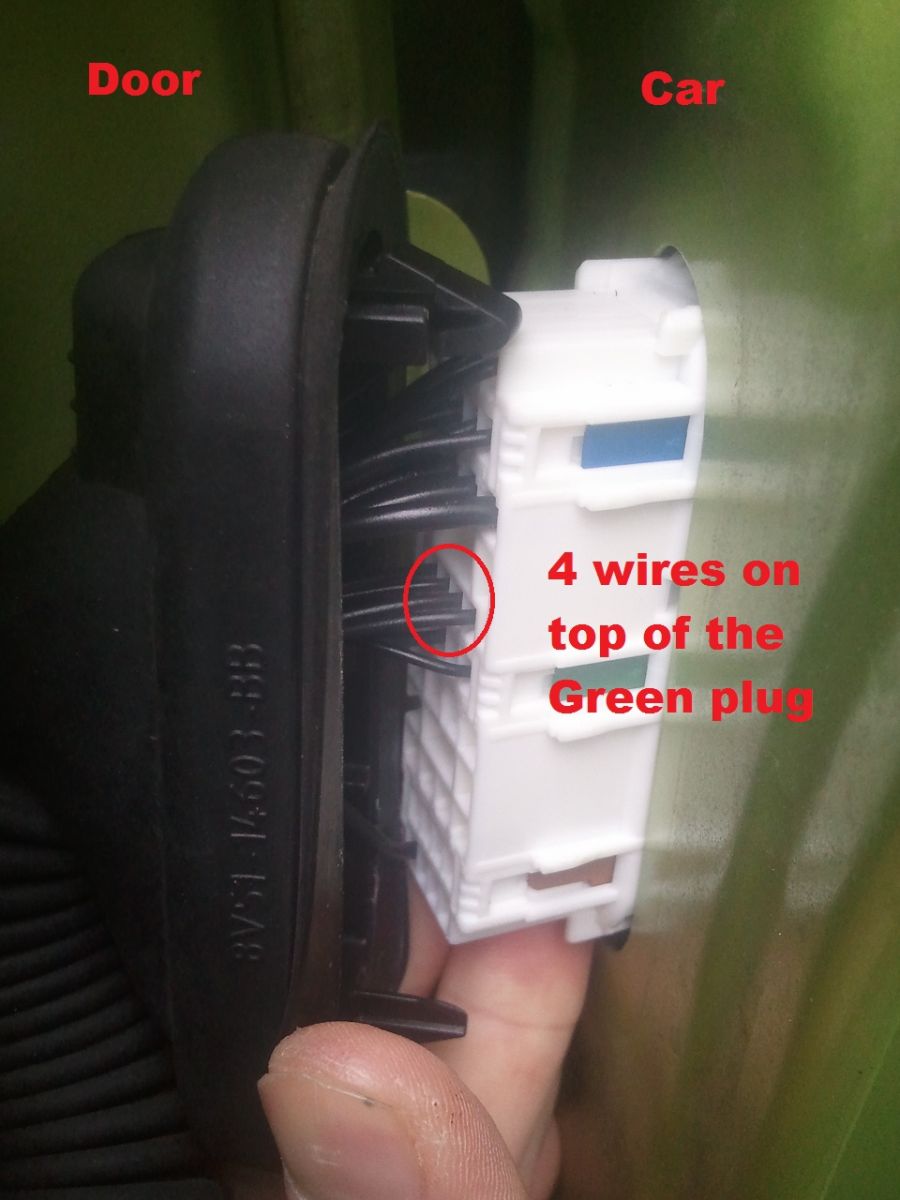

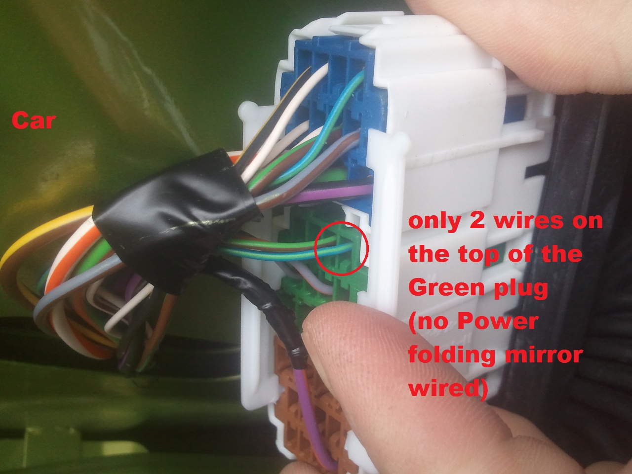

first need to check the wirring...
2012-03-17%2010.27.09.jpg?dl=0
2012-03-16%2011.57.34.jpg?dl=0
2012-03-16%2011.57.53.jpg?dl=0

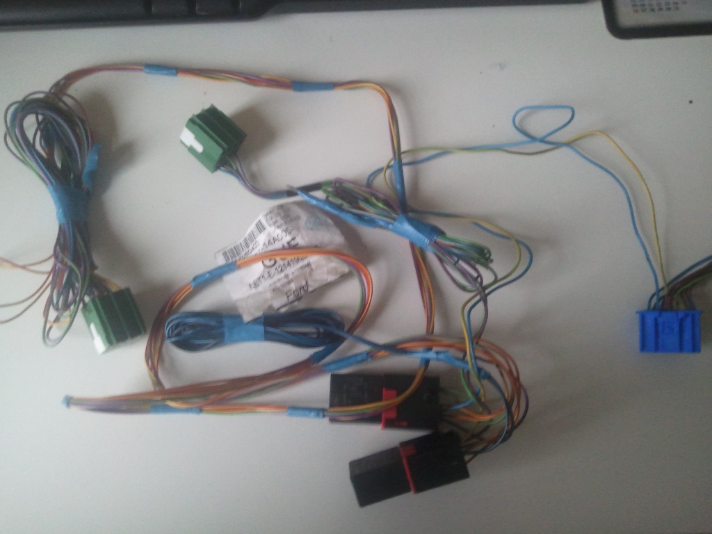

we after the midle green connector....
2012-03-16%2011.58.46.jpg?dl=0
if you have the same like this, you will need extra 2 wire to the passanger side and 4 for the driver side...

if you got 4 wires you may find the two relay in the fuse box for the folding mirror.... and the 2 extra wire to the Blue connector on your body control module
