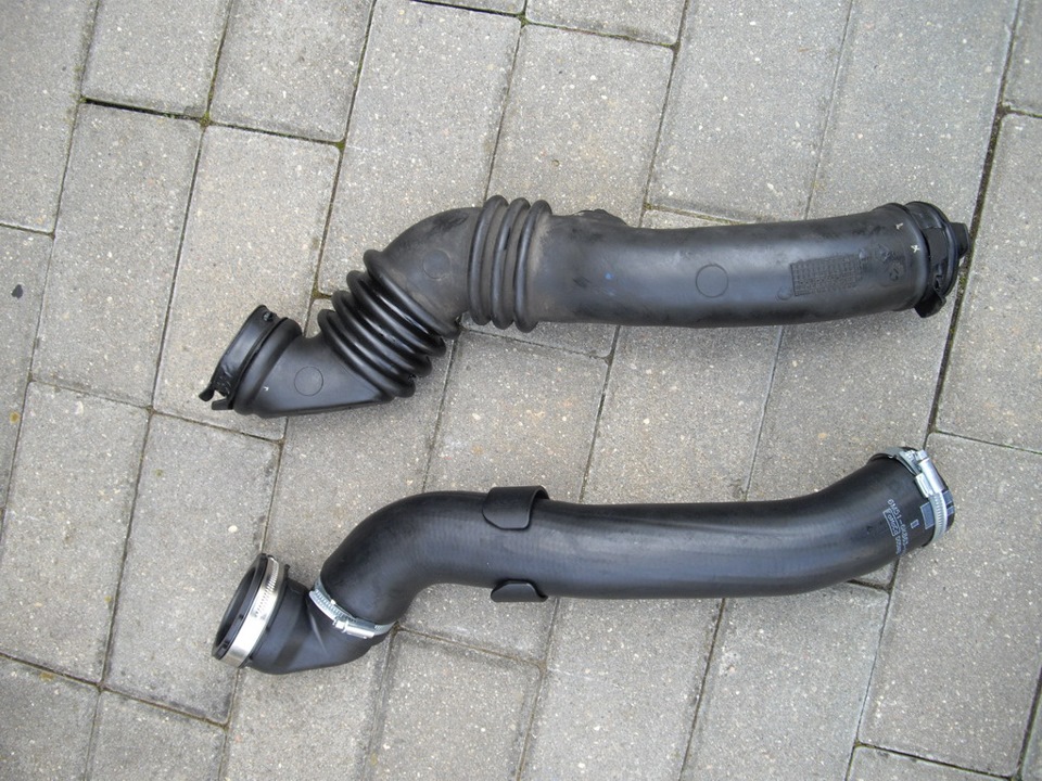

Using data logging dude, iv'e found a split on the intercooler pipe even though I checked it a million times. The pipe that comes from the left hand side with the corrugated sections, right round the back of it, taped it up temporarily to see how much difference it makes. Now I am making 32psi boost, sounds a bit rough as it makes a whistle under pressure but at least I now know a new pipe and it should all be good again. can't believe I missed it, but that pipe is in an awkward place to remove.

Get your self some silicone jobs, not have to worry about it any more after that, just be sure you have the right part, there are two different versions of that pipe which connects to the inlet manifold
You can get OE rubber versions for about 30 quid, 50 for a silicone one from fleebay
I did wonder about using a silicone pipe instead, but there must be a reason why it's made of different material to the rest of the pipes.
I replaced all three rubber pipes with silicone ones, I think they use rubber because its perhaps cheaper?
the only issue with silicone ones is that they can expand a little more, nothing that cant be stopped with a cable tie around the middle of the pipe.
Yeah I get changing the rubber pipes for silicone but this pipe is plastic and hard not sure about changing it for a different type of pipe.
Ah, glad you found the issue! :) 32psi sounds more like it.
Think they changed that pipe (sure mines not corrugated!), silicone should be fine there, they only use hard plastic where you don't need the flexibility of rubber or to stop a long run sagging.
I guess yours being a facelift is the other pipe shown on the parts diagram, just not sure about changing it to a different pipe even if it is cheaper, might just have to suck up the Fraud price to be sure.
It looks like there is a revised rubber pipe with a plastic elbow on it or for later version cars, Fraud show both pipes on the catalog but I imagine the other is probably going to be the same sort of cost.
Even if I bought rubber or silicone pipes I would still need the plastic elbow for it to fit.
Ah, yes mine is the lower of the two, that plastic elbow is going to be tricky to find unless you can find a scrappy. There are always the auto car parts sites, I've found them to be more expensive than going direct to the scrap yard but you might get some luck
Car is now fixed, bit the bullet and bought the pipe from Fraud £82 odd lighter in the wallet but it's done.
It was the lower picture pipe that I was provided by Fraud so I guess it was changed due to failure of the plastic type I had on mine.
