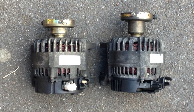

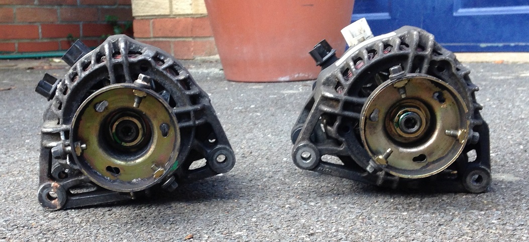

The replacement alternator I got is the correct part but it has the coupling attached, as does the original part, and the couplers are slightly different lengths:
I was thinking I could just swap couplers but I can't get the damned things off! Is there a trick to this or a special tool?
I put a socket on the retaining bolt but can't hold the alternator still.
Any bright ideas on how to get the couplers swapped?
Drop them round to a local garage and get them to swap them over, they will use a air gun to rattle the nuts off and on again.

Just to close this one off - a helpful local garage used their air gun to pop off the coupler in a vice.
Fitted the replacement alternator and all is working nicely again.
