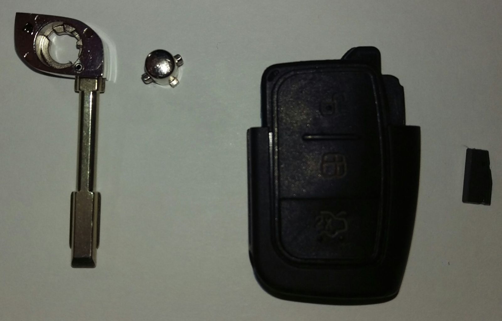

I accidentally washed my flip key that I bought for my car, after having a clean it knackered the remote control PCB so it would only lock my doors not unlock them.
I bought another flip key to replace the PCB and program it to my car.
Whilst trying to swap mine into the newer case the horsehoe part of my old key had been glued together and broke while trying to separate it.
So I have used the complete new case and put my key blade into it with the new PCB.
I have the half of my old fob, a Tibbe style blank for the flip key and an unused virgin transponder chip, this is exactly the same as the one in my Key so should work with a MK2 as far as I can tell.
Programming a new transponder will require suitable diagnostics to program this to your car.
I don't really have a use for them now so thought I would offer them on here free to whoever asks first, I will cover the postage cost to you no problem, if people only want one of the bits I will happily split them.

The transponder is new and unused but the key fob is just the housing with no remote PCB and the blank is the Tube style for the earlier Fords, not the flat laser cut key type.
