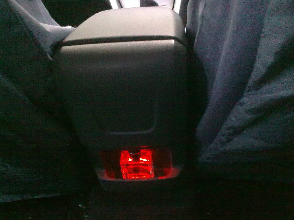

Yes just a safety net , but regarding spillage after i drilled the holes and fitted the led's i used clear sealant to fill the holes from the front so the led's are protected.
i fitted the fuse , so it lines up under the gear lever surround , so if it did blow i can get to it easily just by popping up the surround with my finger nails.
