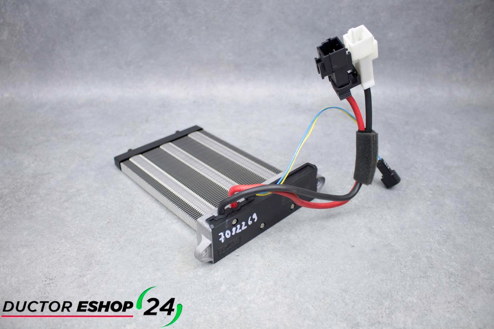

With winter quickly approaching and no garage for my Focus I'm thinking of retrofitting the PTC heater to my 2012 Mk3. Has anyone else here done it? The pre-heater can be had for around 40-50 quid and from what I've found, the cables for connecting are present on 2011-12 cars. The part # according to catcar is 18K463, 1759679. However, the part numbers I see on eBay are BV6N-18D612-** Is it the same thing? It looks like this: s-l1600.jpg
I would be interested in this - is this a cabin heater  for when the engine is cold - I miss this feature from my S-max and from my last few cars!
Yes, that's what it does.
You should have one standard with yours being diesel.  Have you checked ETIS for 'supplemental heater'?
nope I have not checked.
When i put max defrost on, it doesnt seem to warm as fast as my S-max does, which is also a 2.0 litre diesel.

"Less Auxiliary Heater" I think that's the option for the PTC heater but I might wrong
Oh...guess you don't have one then!  Shoulda bought a 1.6TDCi as they definitely do... :laugh:
Yep, although it's also known as a supplemental heater on some.
Auxilliary is parking heater I believe though in ford speak... In our S-max manual Auxilliary is definitely the parking heater, not the PTC...
Hmm, on the Mk3 Focus its known as park heating rather than auxiliary and is in the right place, between cruise and IC. :unsure:

Just checked a facelift 1.5 TDCi and that's the same as the PFL with supplemental but no mention of park or auxilliary.  Very odd!
  •  Speed Control And ASLD
  •  With Supplemental Air Heater
  •  Conventional Instruments - Level 3
Also checked my neighbours ST-TDCi and that's the same as yours, less auxiliary heating.
Edit - 2016 2.0 TDCi Zetec S also has supplemental PTC...so why wouldn't the ST? 😮

2nd edit (lol) - 1.6 EcoBoost, no mention of supplemental, but without auxiliary.  I think aux must mean the PTC on these.
  •  Less Auxiliary Heater
Well mine is a MK3.5, so im not sure what that means - either PTC isnt an option to select or not select, so its always or never there?
So why would we not have the PTC? cost down for mk3.5?
question is can it be retrofitted? this cant be the first time someone has asked this?
The Mk3.5 diesels still get them as proved above, it's only the ST-TDCi that doesn't, I don't think cost is an issue with the ST though.

I've got one installed in my 1.0 ecoboost focus that I bought off eBay. The small wires are there in the loom of my car but the thick live and earth are not. I haven't got round to running the thick cable via fuse in battery box fuse box. Also it needs enabling via central car config.
Yeah I found a video on youtube in turkish, that shows them bolting a piece of loom to chassis in wheel arch, assuming thats the earth, the loom was there on that car, just not bolted up to the arch which is a bit odd. But i guess every bolt saved...
Ill have to take a look in my car to see if its definitely not present, but I expect it isnt based on the list. Just seems a bit odd.
Did any other ST owners have any light to shed on this?
  • 1 month later...
Should I expect any significant differences between BV6N-18D612-AA and BV6N-18D612-BA?
It was around 0* this morning and as soon as I got in the car I regretted I hadn't installed this earlier..
After doing some additional research I'm reaching the conclusion that this retrofit is not possible on the 1.6 EcoBoost without also replacing the alternator. The car comes with a 120A one if the auxiliary heater isn't fitted and with a 150A one if it is - http://catcar.info/ford/?lang=en&l=bWFya2V0PT1ldXJvfHxjYXRfaWQ9PTExMTA4fHxjYWJicj09R0NCOHx8dGhrPT0zfHxzdD09NjB8fHN0cz09eyIyMCI6IkV1cm9wZSIsIjMwIjoiRm9jdXMgQ0I4IDIwMTEtMjAxNSIsIjQwIjoiNCBFbGVjdHJpY2FsIiwiNTAiOiI0MTQwMiBFbGVjdHJpY2FsLkFsdGVybmF0b3IgQW5kIE1vdW50aW5ncyIsIjYwIjoiNDE0MDIwNUIgQWx0ZXJuYXRvciBBbmQgTW91bnRpbmdzOyAxLjZMIEVjb0Jvb3N0IFNDVGkgIn18fGFscGhhPT00fHxncm91cD09NDE0MDJ8fHNlY3Q9PTQwMDdBSkR8fHNldD09Qjg0MTQwMnx8aW1nPT1HMDIzNTE2NjA0fHxmMTI9PS03NDY1MjUxODQrMTM1. This is quite strange as the 125PS 1.0 EcoBoost comes with a 150A alternator as standard..
Hello from Greece! I have a 1.5d Diesel Mk3.5. It had the power wiring for the ptc hidden under the passenger carpet. By the way the problem is that it makes a 12v+ but the Black ground cable is not connected to ground. Anyone know where to find it to Bolt it?
Finally after some search to wiring schematics found the ground cable protected and ungrounded in the right front wing arch! Now I have power for the ptc!
Hello, there is no problem with the alternator. The car have all the safety systems to protect the alternator and battery. I have installed ptc heater with the 120amp alternator on 1.5 diesel no problem. But! If you have the lights on, the fan full speed, heated seats on etc, maybe the car would stop the signal to ptc or decrease it to 50% or lower in order to not overload the alternator and battery! Go ahead install it! Then with FORSCAN you can check the percent the PTC Heater works.
