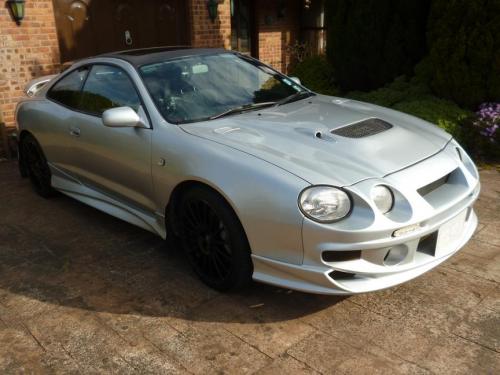

Here ya go buddy, a 1995 Toyota Celica GT4 - a real wallet buster!
(Reckon a Cayman GT4 won't be troubled with seized calipers for a few years yet LOL)
