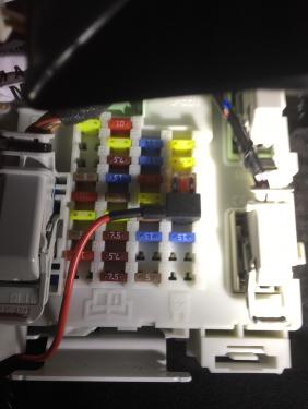

@Hostahousey this may help, i had strange electrical problems in cluding dash cam not workinf so had to investigate the fuse box, several loose fuse due to passengers feet i think, sorry cant read the fuse number but the picture will give you the location, it earthed on a srcew that just above the box hope it helps. I think the fuse is F86.

i have a Nextbase 512 dash cam, very good quality video. i wired it in myself to fuse 61 piggy backed. one tip if you get a nextbase buy the genuine fitting kit as aftermarket ones while being cheaper dont have the correct mini blade fuse holder.
been using it since last August with no problems at all.

A good point re fitting kit. F61 stays permanently live on my car but it is the newer model.
