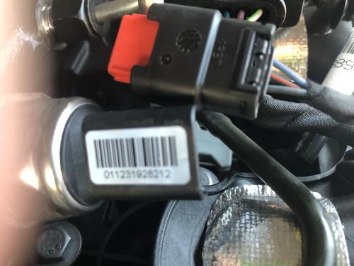

i have a mondeo 2.0 zetec 2013 plate ok ive been told by emg that i cant change the fuel rail sensor they have told me that i would have to buy a new fuel rail ive had a look around and foud fuel rails on ebay now the question is will it have to be coded to the car or can i just change it also the image below is my sticker on my fuel rail now on the one i looked at which says its for my car the big number at the bottom starting with 130 is diffrent does this matter the 9681909680-03   cie compiegne  and 28497z01  are the same many thanks
You can buy the sensor separately, just not at a Ford dealer.
thanks mate they told me that the sensor was sweated on i take it it unscrews  i have to say i am having trouble finding one any idea were i can get one

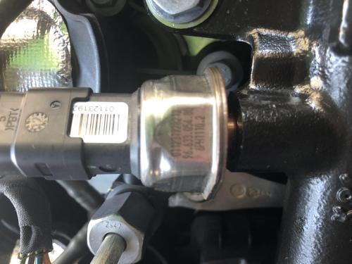

this is the sensor
2 hours ago, spikes travel said:
this is the sensor
There are loads on ebay.  I believe they're the same as the Mk3 ones and just screwed in but you would have to double check with the sellers unless someone else on here can confirm.  The part number appears to be 9663305480 etched into the sensor.
