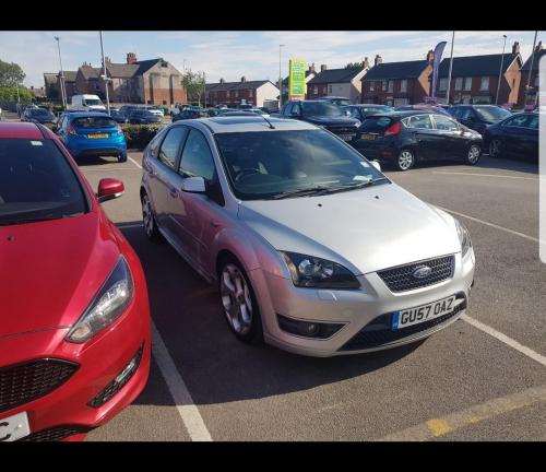

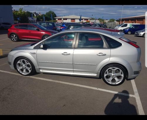

I have uploaded pics of the one I have put a deposit on.

I've bought a facelift ST-3 in performance blue the other month. It's a brilliant car, just very thirsty. I found the seats in the ST-2 to look cheap and nasty tbh. The leathers in the ST-3 make the interior look 100x better. Plus they're heated which is a bonus.
1) They're optional extras available to all the trim levels (ST-2, ST-3). Most people don't get many options on the ST2 as they would get them on the higher spec ST3 instead. The sat nav system is a bit crappy compared to what you get now and most the maps are years out of date.
2) I wouldn't stay clear, but just ensure the work has been done to fix the issues. I doubt the block mod will have been done, but if you're not remapping then it shouldn't be needed.
3) There's a whole heap of websites that sell mods for both facelift and PFL MK2 ST225's. The rear diffuser is a popular mod, but a bit harder to do on the PFL as it's not a straight swap depending on what you buy,
4) Evans Halshaw can be a complete pain to deal with in terms of after sales/warranty issues. The extended warranty isn't really worth it. The stuff they actually cover you for is pretty much nothing, meaning you're better just putting the money aside just in case something went wrong. Be careful what they say about head gasket and clutch. If the clutch fails because it's worn too much, they won't cover you. They can only find that out once it's been stripped in their workshop, so unless it was a total failure, you'll have to pay that cost even if you decide not to get it fixed there. The good thing about the MK2 ST is many of the engine parts are available directly from Volvo meaning it costs half the price. Of course if you're sending it to a garage for the work then it can cost a fair bit.
5) Yes most definitely. I need to order the bits to do mine at some point soon.
6) It's a CAT N meaning an insurers wrote it off being uneconomical to repair but hasn't had chassis damage. Kinda explains why it's cheaper to start with. However, mileage is a huge factor towards the price of the MK2 ST's, the year doesn't make any difference (as long as they're both pre-facelifts). Also the 3 door versions tend to be worth more too. I guess you don't see many Focus's with a 3 door other than ST's/RS's so does increase the value a bit. The "plain" colour ST's wont hold their value as well either, and can be harder to sell not really fitting in with the ST's "ASBO" culture.
