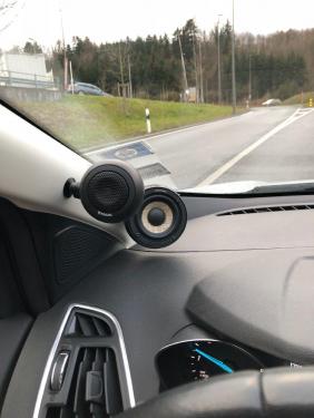

@hampi Many thanks for this thread. I’d like to upgrade the B&O Play speakers in my Fiesta too. I find the mid-range in particular too shrill.
What isn't entirely clear to me yet: did you upgrade the B&O amplifier during stage 1?
On 9/17/2019 at 11:04 AM, hampi said:
replacing middle center for real B&O .
after try several types this fits fine with sensitivity and size also cover square hole to make acoustic right
What did you use in the photo above to cover the hole near the mid-range driver? Insulation wool and a piece of cardboard? Or metal?
