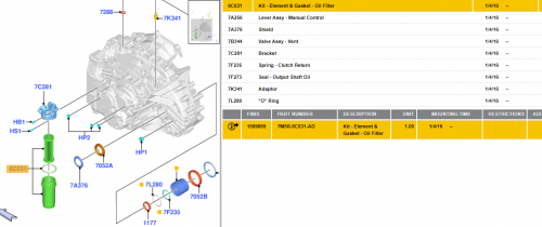

Agree, change the oil as recommended in the service schedule but there is no stripping. The filter is in a small housing hung on the side of the box, like a mini engine oil filter. The cost is due to the ridiculously expensive oil.

Based on my 2017 titanium the trans filter is external to the box in an unscrew able housing and 150000 mile change

My local stealer (Lookers) wants £500 to change the oil and filter on mine at 4yrs or 36000 miles - ***** ridiculous
Can get the oil and filter for between £150 and £300 depending on supplier and it is a straightforward job to do as per @Tekno previous post and this video (ignore the long winded commentary)
