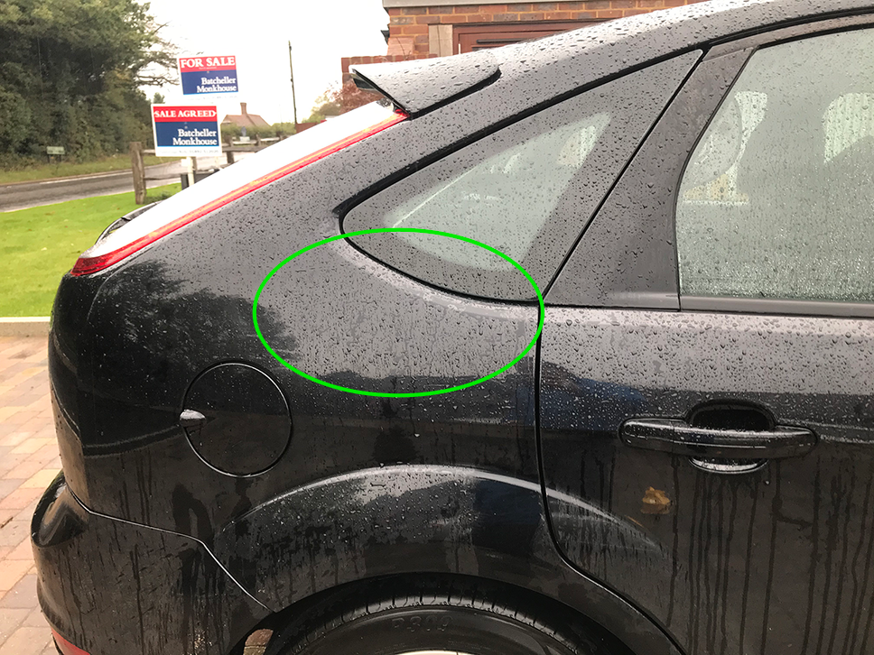

For context, here is an external shot and the area I can see the water coming in:

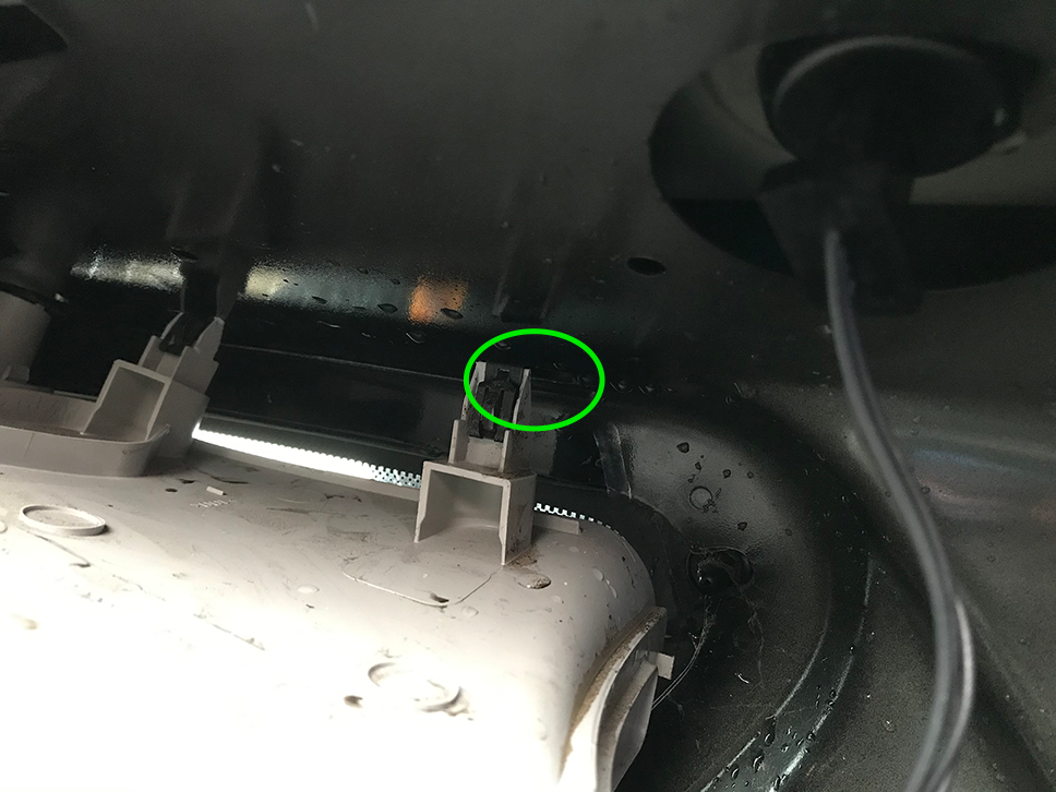

The water is coming down through a hole the trim clips into:

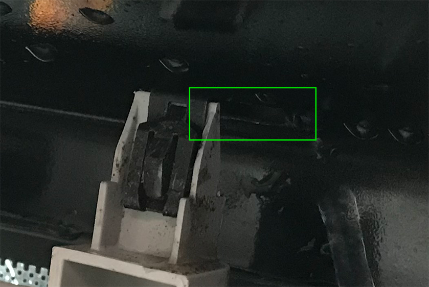

Heres the exact point the water is coming out of, the square hole the trim clips in to:
That's the point the water is coming down into the car, however I can't find where the water is actually entering from the exterior.

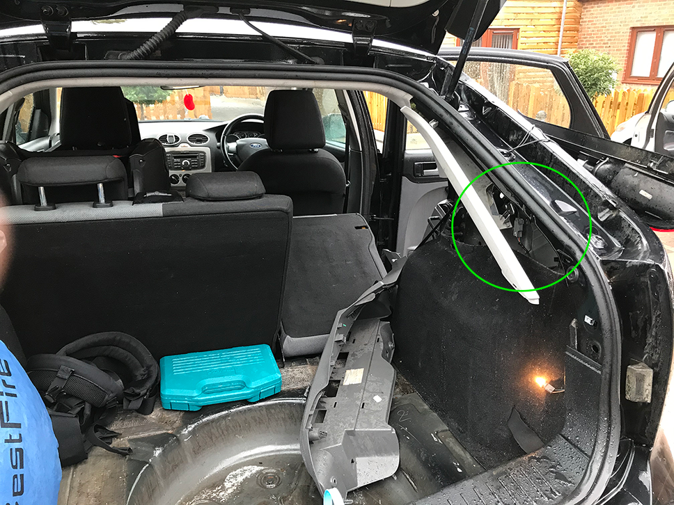

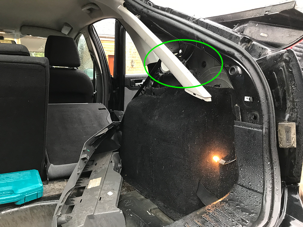

For a little more context here's roughly where the point the water is coming in to, so of course the water is coming down from a higher point:
Have removed the light and seems to be no issue there (the screw gromets or the wire gromet). When it's not raining will do some more tests with a watering can and see if can pinpoint anything, the trouble there is it does seem to accumulate and then drop, or at least there's some inconsistency it seems which might make this a tricky method to be 100% sure, but will try again. When it was a heavy downpour the dripping was quite heavy and pretty consistent.
