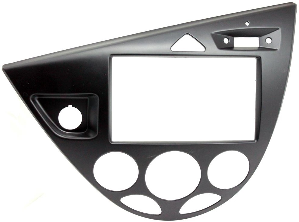

3. Install an aftermarket dashboard panel with a 2 DIN hole. These are available in Silver and Black (or can be painted in any color you like). This is in my opinion the nicest option.

I really like the idea of no.3, but my focus is the Ghia and would like to keep the wood coloring if possible (might have to break out the airbrush and practice lol).
I have a spare (grey) dash as needed new clock and cigarette lighter, so will look into mods with the Metra Kit, have already practiced making couple of small rectangular holes in it for a 2 port USB adaptor lol.
If I was to get the 2-din dash, are there any Ford 2-din stereos that would fit nicely, so that I could still use the cd-changer.
