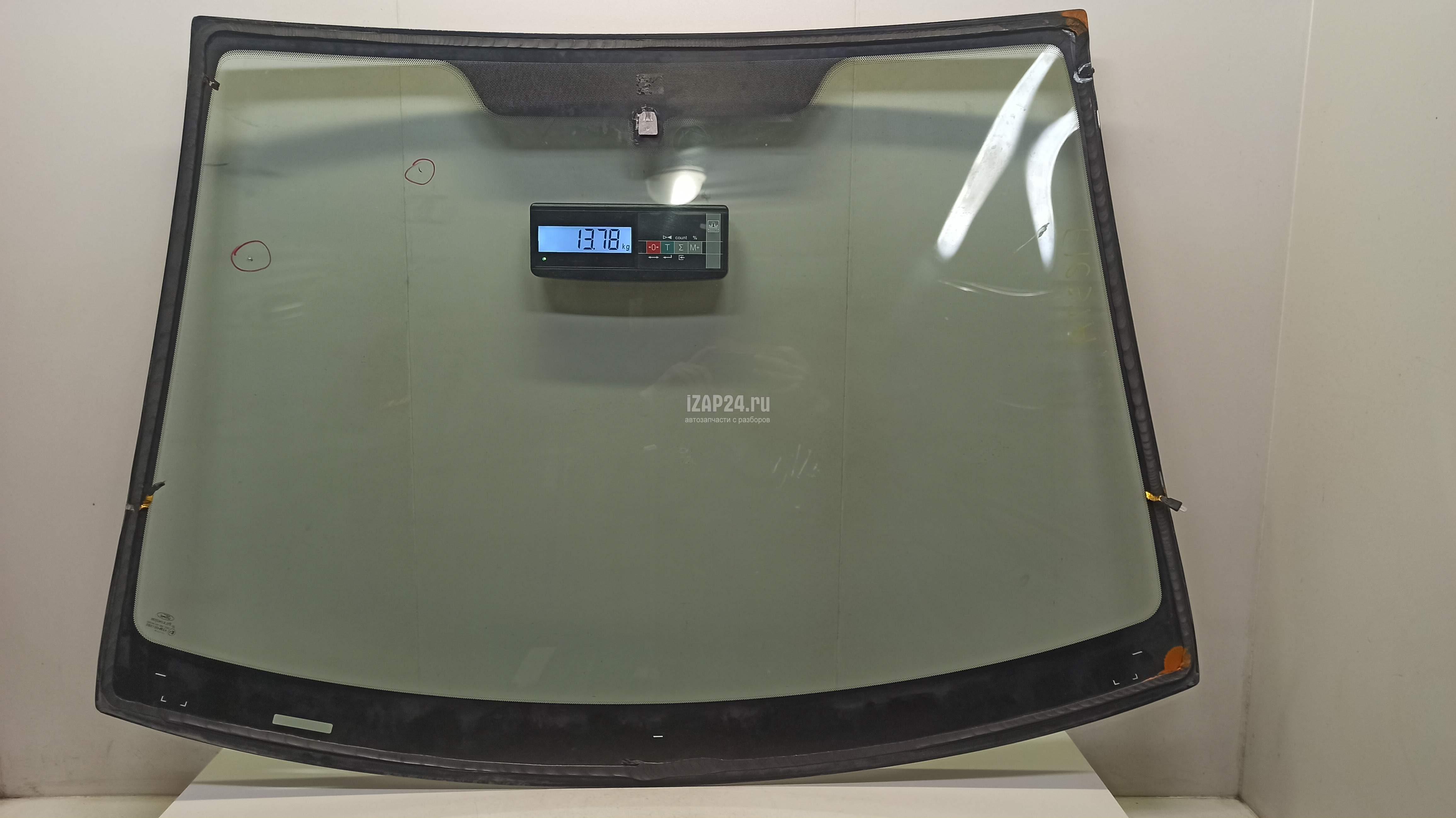

10.jpg?watermark=izap24.ru
2nd time out today - no change from before - see photos. i was able to use direct the hot air from the heating vents to windscreen to clear. So I guess this will get me by for the time being. I see in the Haynes manual it states there is a diagnostic facility (no special tools needed) to test electric circuits for all the main features inc windscreen heater. Will try to do this tomorrow - but as it's working partially I guess there are is no blown fuse.

That's just a simple case of the heating elements in the screen failing. Only fix possible is to replace the windscreen. Once they start to fail they tend to all go.
That is an odd pattern, with both sides failing in roughly the same place at the same time.  As has been said above, the two halves are independently powered so not a fuse or cable issue.  I guess it must be a coincidence, just seems very odd!
If you have windscreen cover on insurance, that's usually the best route for replacement.  I note yours has auto wipers/lights as well, which was rare on the Mk6's.  Make sure the fitter brings the correct screen if you do have it replaced.  Took 2 attempts to get the correct screen for my Focus...and then they broke the sensor and had to come back a third time to replace that as well. :rolleyes:
