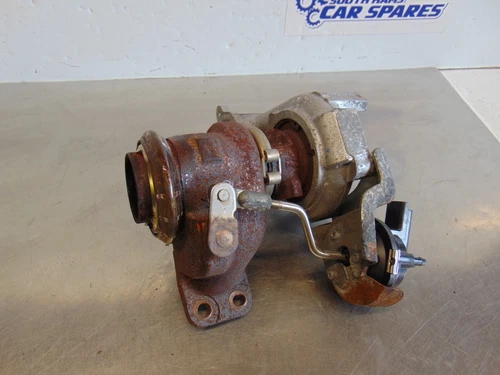

The wastegate probably is just rusted solid tbh.  It's not a great design.  The petrol wastegates have the opposite issue, they're loose and rattly, no idea how they're all being built so badly as Ford don't even have a hand in the turbo design.
Ford Fiesta Turbo charger 1.5 TDCi diesel 12-16 mk7 facelift 9804945280 - Picture 5 of 12
