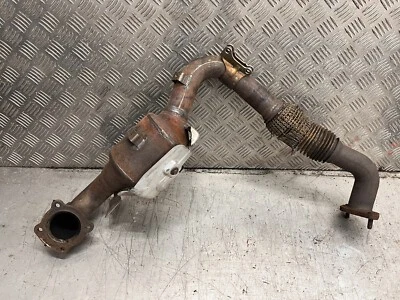

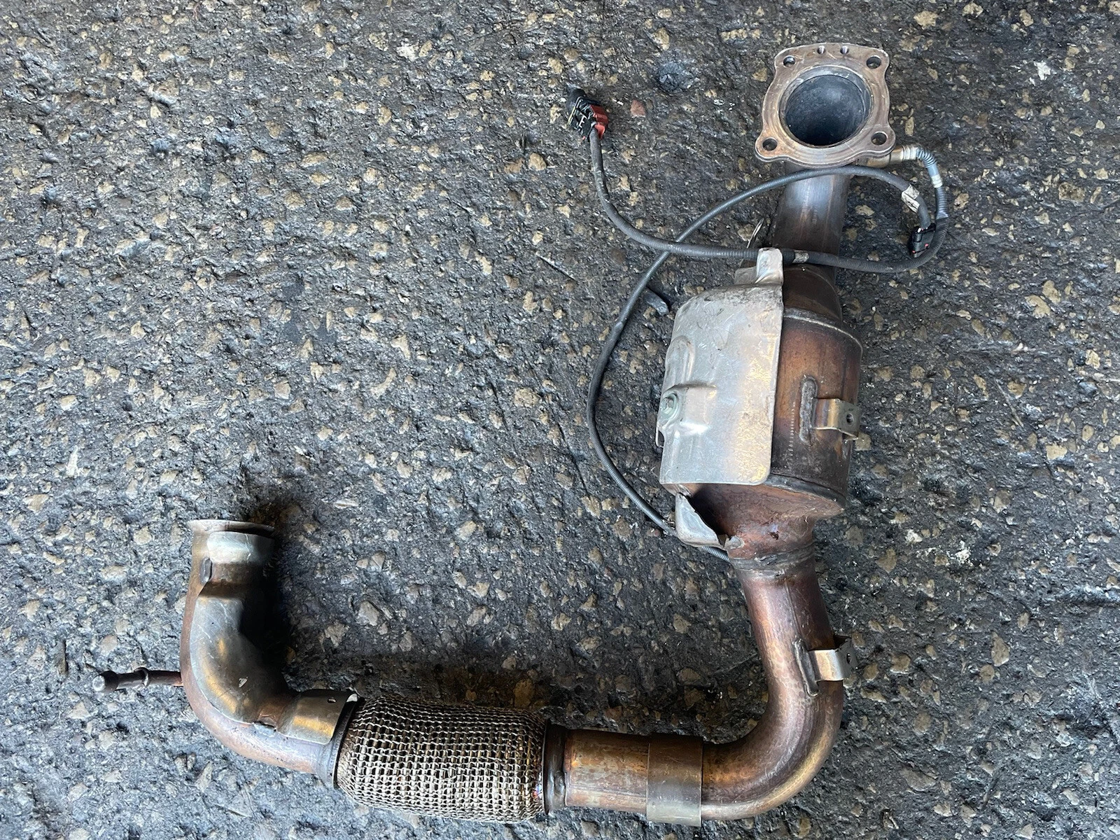

The MK7 1.0 ECOboost cat is also not going to be a direct fit onto the MK8 1.0 ECOboost wetbelt engine.
Yes, it does fit onto the turbocharger but the shape and dimensions are slightly different. Apart from that the MK7 has a flange mount and the MK8 has a clamp mount at the exhaust side.
To make the MK7 cat fit onto the MK8 welding is required.

so it would be possible to screw onto the turbo and at the exhaust side but just need work to get the mounting correct?
No, it will not fit at the exhaust side.
Different dimensions (pipe lenght / pipe angles) and a flange mount (MK7) VS a clamp mount (MK8).
FORD FIESTA MK7 MK7.5 13-18 1.0 PETROL ECOBOOST CATALYTIC CONVERTER 1174473X - Picture 1 of 4
MK7
FORD FIESTA MK8 2017 ONWARDS 1.0 ECOBOOST CATALYTIC CONVERTER H1B1-5E211-AC - Picture 1 of 3
MK8
Cutting/welding is required to make the MK7 cat fit onto the MK8.
