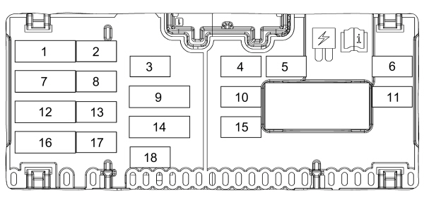

I have a picture taken today of my fuse box under the front passenger flap thing.
Not much choice there!  Also need to know which size fuse tap you have, as there are two different sizes.
I have two micro 2 fuse taps
Ok, so that's the smaller of the two in this box.
F2 is for Park Assist module.  That should be ACC, and not essential if that function was lost by a blown fuse.
F10 is for filler flap.  That should be permanent live.  Generally I would try to find a non-essential item but can't see a better one there.
Identifying the Fuses in the Body Control Module Fuse Box
Image Shown Without Description
Item   Fuse Rating   Protected Component
1   5 A   Restraints control module.
In-vehicle temperature and humidity sensor.
2   10 A   Parking assist control module.
3   10 A   Ignition switch.   Push button ignition switch.   Telematics control unit module.
4   20 A   Lock.   Unlock.
5   10 A   Moonroof.
6   30 A   Right-hand mirror switch.   Right-hand front power windows.
7   5 A   Passenger airbag deactivation indicator.   Auto-dimming interior mirror.   Wireless charger.
8   -   Not used.
9   5 A   Central security module.
10   15 A   Child safety locks.   Fuel filler door.
11   30 A   Left-hand mirror switch.   Left-hand front power windows.
12   15 A   Heated steering wheel.   Headlamp control module.
13   15 A   Voice control.   Compact disc player.
14   7.5 A   Battery back-up sounder.
15   10 A   Anti-theft alarm horn.
16   7.5 A   Steering wheel module.   Instrument cluster.   Data link connector.   Climate control.
17   20 A   Audio unit.
18   -   Not used.
