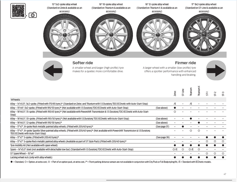

for 14 inch wheels, 175/65 14 was used for the base level Fiesta and the spare wheel for many years. This is from the 2016 brochure.
If your car had 17 inch and your wanting smaller 14 inch, please check, using tyre calculator sites to ensure the outside diameter of each are the same. Your speedo might be wrong if different. This is the difference between my Mk8, 17's and the spare.
To me, notwithstanding whether 14's might clear the brakes, everything points to sticking with one of the OE 17 or 16 inch combinations as above.
