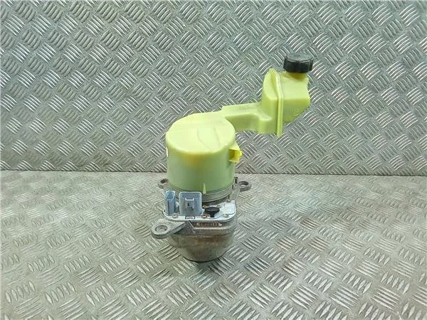

1.6 TDCI used electro-hydraulic PAS, like the Focus.
The reservoir is slightly different though.  It does have still have a MAX mark written on it.  Can just about see it on this picture of a used one.  Only just above the long 'arm', nowhere near the top of the bottle.
5S613K514Ag Power Steering Pump Ford Fiesta V (Jh_, Jd_) 1.6 Tdci Hhja Electrica - Picture 1 of 6
Thanks tom the photo is helpful. No fluid in sight, so I bought some from Halfords Yesterday. I'll try giving things a wash or at worse put some in with funnel and pipe leaving level down not near top of bottle as suggested and check things after a few trips. Annual milage is 2500 so it is mostly retired. like owner.
