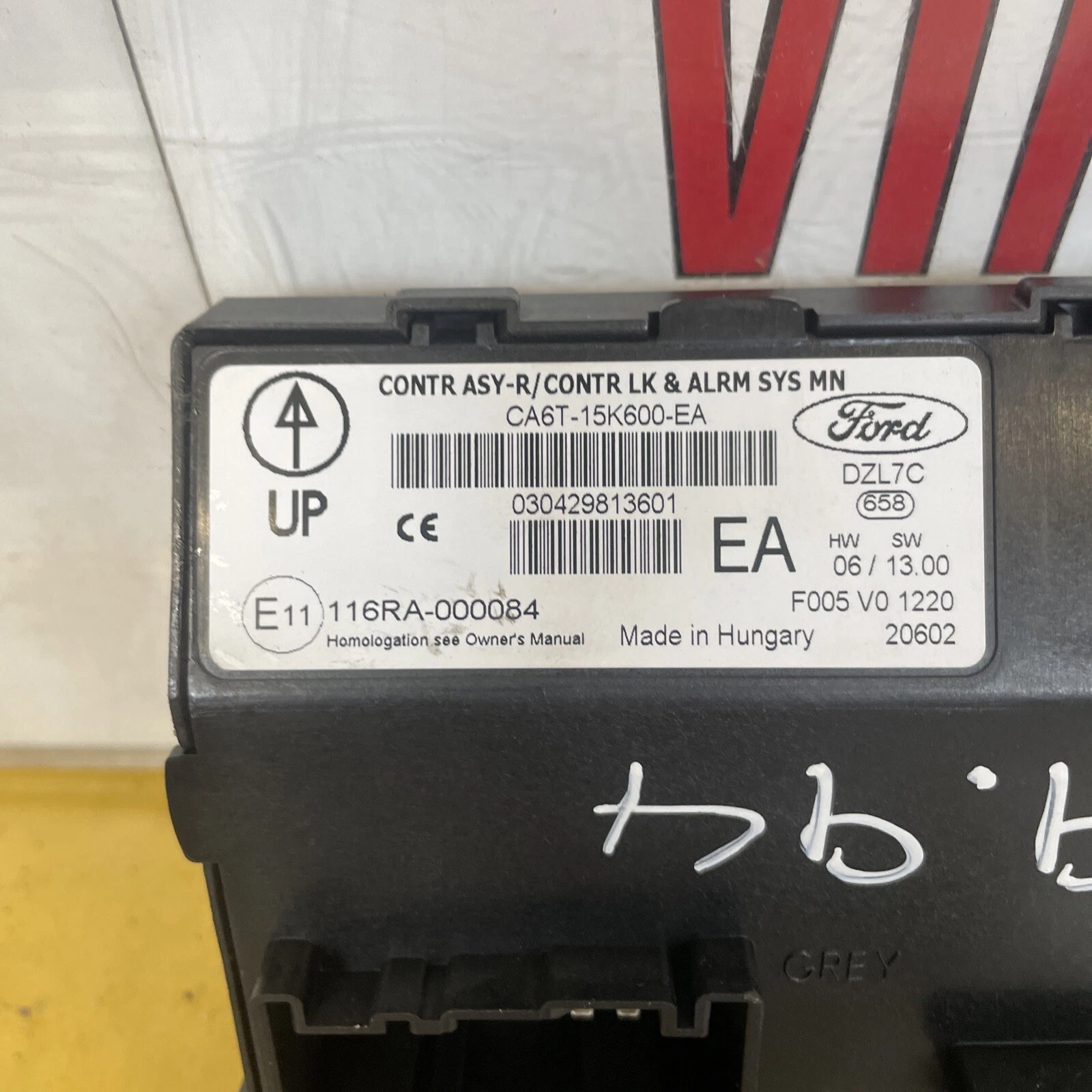

There was a different central locking module for non-remote Mk7 Fiestas so it may not be as simple as just adding a remote.  It's also possible the RCL module was integrated into the BCM for the facelift MK7's.
If you can get on the floor (and back up again!) have a quick look under the glovebox to see if there's a white label on an RCL module like this one.  If it says R/CONTR then you should just be able to add a remote to it.
Ford Fiesta Mk7 Central Locking And Alarm Module CA6T15K600EA 2008-2012 Ref 117 - Picture 3 of 13
Awesome reply mate, made me smile :-)  Thank you
Tom, cheers mate, just climbed under dash and found exactly what you described. Onwards and upwards buddy, thanks a lot.
