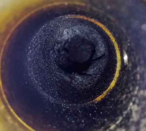

If I was you I'd start by cleaning the intake manifold and check that the engine is running properly first as the 1.8 tdci is getting old and is probably choking up with carbon
If the EGR hasn't spent most of it's life blanked then it will be choked with carbon (although this isn't an "issue" specific to this engine more diesels in general).
This was the state of my inlet manifold
With under 45.000 miles on 2006 focus
5 minutes ago, Dave sport tdci said:
This is the state of my inlet manifold
With under 40.000 miles on 2006 focus
That's exactly what mine looked like...the joys of having an EGR on a diesel.
