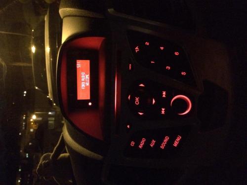

In a bit of a mess here, the other day I went to go to work, turned my key in the ignition and radio 1 didn't come on as normal, just silence. on the media screen above the radio controls all it said was "Ford Audio Welcome" and was frozen on that with no sound at all. I could turn the media centre on and off as normal, however each time I turned it on all I'd get was that message and in the bottom right hand corner of the media screen there is a constantly lit little red cog (see photos). There has been no disconnecting of the battery and no power drains.

Sounds like it's locked itself up.
The usual remedy is to disconnect the battery or pull the radio fuse for 20 -30 minutes to force a reset.

Ah yep, definitely no code on a Mk7, couldn't see your pictures at first so couldn't confirm radio type by images.
Defo pull the fuse or battery and do a 'hard reset'.

just tried both disconnecting the battery, and taking the fuse out for an hour, and no luck! :( any other suggestions?
