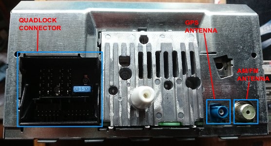

Your "Sony radio" is a Bosch/Blaupunkt satnav - Travelpilot FX, if you posted the correct picture.
Not 100% but I think there's a blade fuse on the back of the radio visible when you remove the main quadlock connector .

The Travel Pilot FX has a 15A (usually blue in colour) mini-blade fuse in the right part (as viewed from the rear) of the Quadlock connector (the main cable plug) on the rear of the unit.
You will need to unplug the Quadlock connector to gain access to the fuse.

I removed my stereo and it appears I have one of the affected units. I have just rang local dealership and they will be phoning me back with more info. Will post an update on here.
Have had the car inspected by local Ford dealer today and they are replacing under the warranty :)
Stereo may take up to three weeks to come in and I am waiting to put the car up for sale but not the end of the world.. worth the wait for a free replacement!
