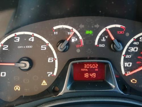

Dash warning lights (Auto start-stop, EOBD injection system failure, Generic failure) later versions also have Tyre pressure low & Hill assist unavailable I believe.

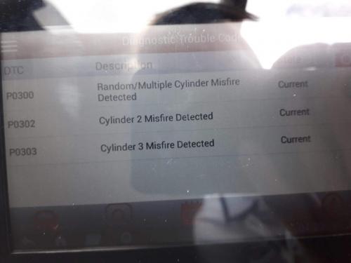

Daughter purchased a 2011 Ford KA June 2019.  (Fiat based) In car history cambelt changer 2016 at a Ford main dealer. Soon after purchase the car would start to have a major misfire if on motorway / duel carriage way when cruising at about 2750 / 3000 rpm, 60 / 65mph. Pull off road switch car off and back on it runs fine until the cruise down the major road but it is random when the next episode will be. I suspect the car was sold with known fault or was a town car as very little miles since cambelt changed.
I changed spark plugs and swapped coil pack and leads off another same year car I own but it still happened. Local garage code read P0300 (multiple misfire) P0302 cylinder 2 misfire detected and P0303 cylinder 3 misfire detected. Pointing to plugs, leads or coil pack, but they have already been changed.

YOU ARE A HERO!! I’ve been chasing this fault since a cambelt change & re-checked the timing a 3 times!! Spoken to ford work shop controller who knew nothing about it & said it would 100% be timing issue. Exact same faults/symptoms as you.

The pictures and faults you have posted are identical to what I am dealing with.
