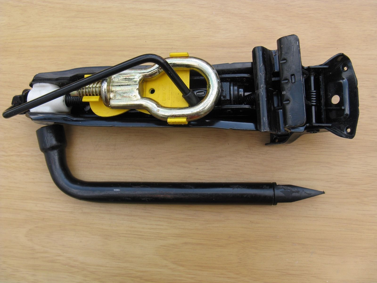

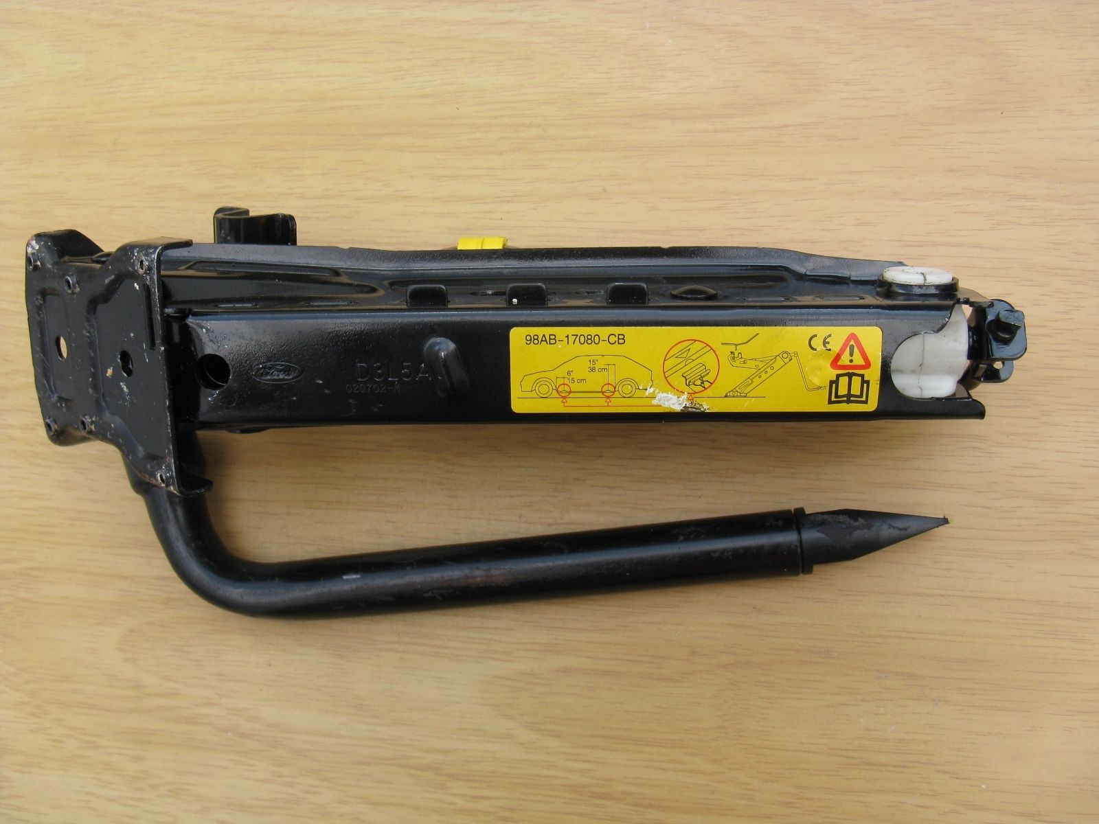

Just to follow this up I decided to try a jack from a Mk 4/5 Fiesta given that they are widely available on eBay and hence very cheap (<£10 all-in):
It fits fine, and performs well (at least as well as any scissor jack anyway!). The wrench is also the right size (19mm) but the towing eye is very different (the Mk 7.5 is much longer) so I'll dump that.
I would think the difference is due to the increase weight of the car. Might be worth checking the safe weight of the jack you've purchased to be on the safe side.
Yes, you're likely right as the full scissor version seems to be pretty much the standard on larger models (and vans). This one will be fine for the Fiesta given how light it is.
