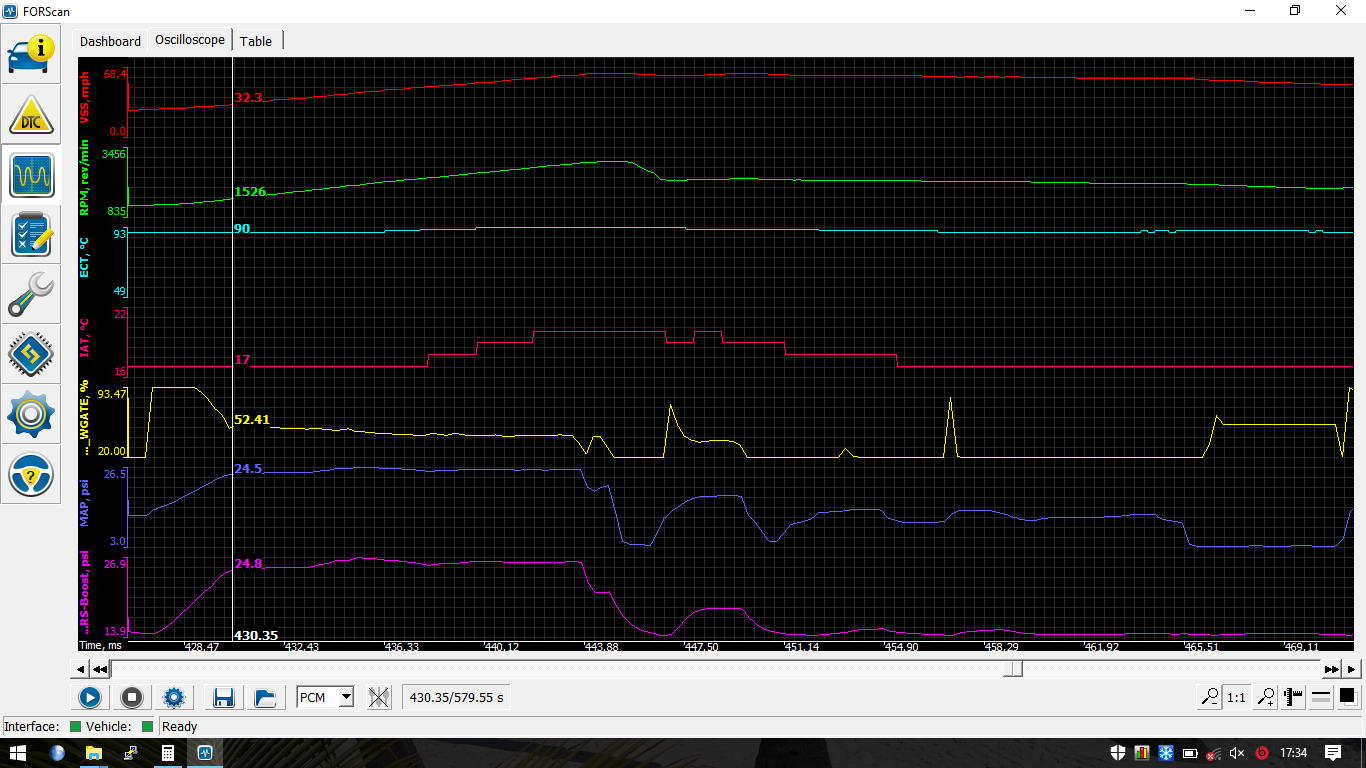

I did a bit of experimenting with FORScan today to find when peak boost is achieved. I can confirm that (on the 100PS Ecoboost at least) max boost (or as near as damn it) is achieved as early as ~1500RPM as the torque curves mentioned above hinted at:
20170628%20Forscan%20Plot%20of%20turbo-r
Note that the sensor is reading absolute pressure hence atmospheric pressure (~14.7PSI) needs removing from the figures to make conventional comparisons.
I am assuming that it is the combination of such a small turbo coupled with the variable valve timing that results in all-available boost being offered so early on in the rev range.
I suspect that the reference to peak boost being at 2500RPM may be in relation to discussion of Ecoboost engines in the US as I have read in a few places now that there may well be differences in configuration of their versions (perhaps due to the different emissions requirements and/or typical operating environment?).
