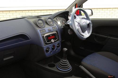

Looks good!! Hope you manage to get it all functioning okay. I've thought about doing something similar as I've always thought the facelifted Mk6 interior was let down by the unchanged steering wheel; especially in my Zetec Blue with quirky colour scheme and Sony stereo. Plus I'm all about the OEM modernising modifications! I think I'd either get a low-end Mk7 steering wheel without audio controls (that would mean sacrificing leather though) and keep them on the column; or try to wire up the audio controls on a steering wheel with them fitted (as in yours). Would probs get one without cruise control though as I don't like redundant buttons! I made a quick and crude Snapchat edit! Could look good...
