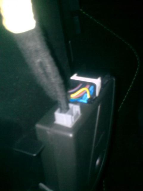

That was until Ihad a good look myself. So this is what I found:
possible bluetooth module?
and this....
Could this be the port that illusively eluded many of us?
Unfortunatley I haven't got a USB skinny enough to fit in there so I can niether confirm that it fits a usb pen in or even works as a port. However could I be right in assuming that the cable that was mentioned in the mighty USB thread is a Ford specific clip cable that goes in and routes to the aux port area and thus this is the missing element in getting my USB dreams off the ground...
Answers on a postcard guys. Am I USB Ready?
I'll be very excited if it is a USB port, I'm so sad mine doesn't have one!
that is the port we at ford use to update the bluetooth, it WILL NOT give you music playback and you can only get the lead if your a ford workshop
sorry to disapoint

i've had a look through the wiring diagram and this is port C3 which is labeled as usb.
just need to know if buying the usb cable would be a good idea or not as is this where it's supposed to go into?
anyone with usb care to take a look. no tools required to get this flap down, its held up with push pins... easy to remove :)
I have USB, what/where am I looking for? PM me if you like.
Ive had a look and it looks like USB could be fitted after all. The USB port which is empty in your's is in use in mine. Here's a pic..
have been having a chat with out master tech today and he says that the cable is around 9 pounds and that they can be bought by anyone, hes bringing it it to me tomorrow for me to get the finis code off of it and so we can try it in a model without bluetooth to see if it works, will updte you around midday tomorrow with this one, and if it does work ill do a bulk buy, seeing as i set the prices:P
ok, so who wants USB and is coming to MK on the 10th as im buying some of these leads as they seem to do the trick as i just unplugged that plug and bobs your uncle, my ipod was "disconnected" i will double check prices tomorrow but should be around £10 although it may need a usb plug for the other end for about £5, although if enough people want one ill do them for pretty much cost price

I have tried to suss this out. By my reckoning the cable needed is the one which runs from the bluetooth module to the headunit,the microphone in the roof and also to the aux port and this cable has an rrp of £105.84 you will also require a new usb port at around £5 and also the trim for them to sit in.
As for programming i dont think it will need it as when i unplugged the lead from my module last night it cam up ipod disconnected and usb dropped off of the stereo. When i plugged it back in all was well

also, whats the £105 get you? i was under the impression that C1 and C2 are part of the same plug (the black rectangular shaped plug), C3 is for the sole use of USB (the empty port). so there's a cable that costs a tone that splits to the usb entry port and to the hu as well?
don't ask how but i can see the wiring diagram for this module (comms module) and the plug leads to one place and one.... the 'usb module' which i hope is just a fancy name for usb port, ie where you plug your !Removed! in.
