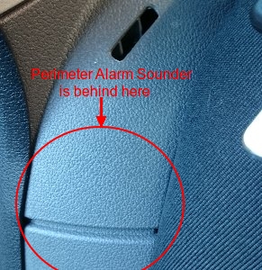

Since I had taken the OSR rear parcel shelf support trim panel off (in order to make easy to drill the hole) I had good look round for a suitable ready made earth point and ran a heavy gauge wire forwards alongside the main harness (the section that runs directly past the upper mounting point of the OSR damper) and used the mounting bolt of the perimeter alarm horn as my earth point as it already acts an earth point for the perimeter alarm horn.
The perimeter alarm horn is mounted by an 8mm diameter threaded bolt (10mm head) just behind the upper edge of the dark lower trim next to the OSR door right where the joint between the C-pillar dark and light trim panels meet (roughly about armpit level when sitting in the OSR seat).

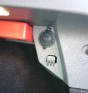

I used cone cutter to make the hole (28mm was needed for my splashproof socket as used in boats) and mounted a 12v auxiliary power socket into the vertical flat area just above the rearmost hook on the plastic trim panel.
Location of Perimeter Alarm Sounder
Position of 12v auxiliary power socket
