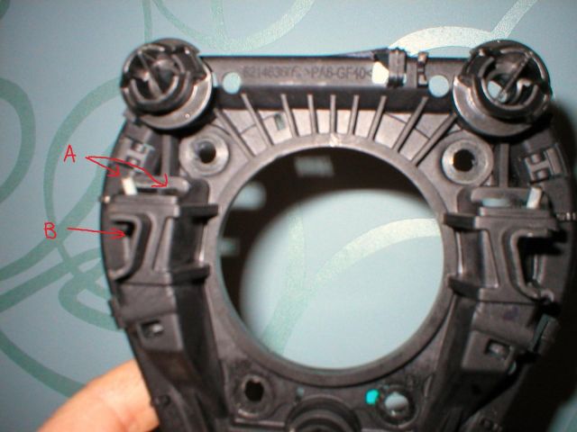

First disconnect the battery! remove steering wheel column top cover, med_gallery_13241_370_68558.jpgthis is the airbag from the back,you need to put a flat bladed screwdriver or lever ( i used a bended welding rod) in hole B and push the sprung bar across towards the centre of the wheel,at the same time pull the airbag forwards ,then do the same on the other side,make sure your airbag doesn’t go off,i think its recommended to leave it for a few hours first to discharge it.

It may just be me, but your airbag is missing from the pic !!! Was that one that had gone off ?
Cheers
it`s not my picture ;) one friend of mine sent this for me how to do it...
