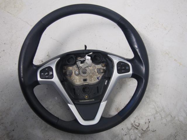

Would this do the trick as required parts if it has the required connector also included?
This is from older model (10-13 mk7) Diesel Fiesta but it looks like it has the same buttons as the mk7.5 Fiesta with cruise control. Can i just detach the the buttons and other stuff and transfer those into my current steering wheel? Im thinking of asking a dealer to do this for me.

Ok. Thanks for the info. Does the steering wheel in the picture I posted before seem to have the correct wiring? It looks like it has three wires/connectors. One black, one white and one whose colour Im not sure about. Are these the connectors for both, stereo and the cruise control?
I checked my car and it has the correct wiring for the cruise control so I guess I will be ordering used steering wheel soon.
