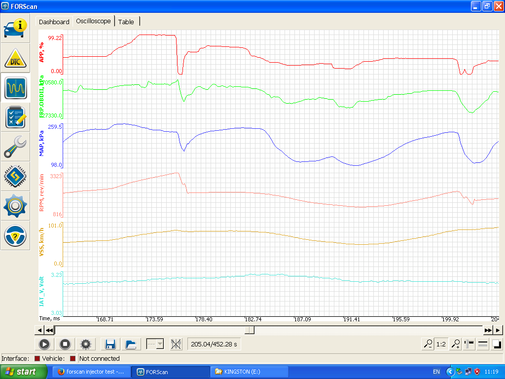

The fuel rail pressure looks ok, at least it is following the desired values as far as I can see from the screen resolution. On my car it more or less tracks the accelerator.
The fuel rail temp looks a little odd. I guess it is a thermistor, so voltage drops with rising temp, but on my car it is much more dynamic, going up and down quite quickly with rail pressure. My system measures the return fuel flow, maybe this is the incoming flow, in which case a gradual rise over the journey would be sensible.
I do not really believe the cylinder balance figures, they just look too good. Again, on my 1.8 I always get exactly the same figure for all 4. I think it is just a filler, put in for compatibility with an arbitrary value, not a real reading.

A Forscan run I did a couple of years ago:LOG-4.PNG
