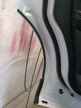

I can’t comment on the new Edge but I was fed up of the dirt on the inside of the doors so I bought some generic automotive seals and cut to size.
Fitted in November and haven’t had any issues with dirt since. No build up of dirt behind the seals. Doesn’t seem to affect the other seals either.
You do realise the slots at each end of the sill is the drain for the inside of the door skins (i.e. when water goes down the window seal!). So you've now prevented that from draining away, which will just rot your door panel from the inside out!
It's better to just wipe it clean and clear the drains every week when you wash it.
@Owen1988 very nice and neat, but like @simonb65 I’d be a bit concerned about the drainage holes. Don’t suppose this would be an issue for some time though.

Have added a couple of sealing strip to mine and much improved.  If you have a look inside wheel arch you will see exactly where the seal strip is needed.  See pictures. Doesn`t go near drain holes so no worries about blocking drains.
