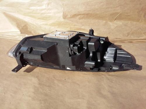

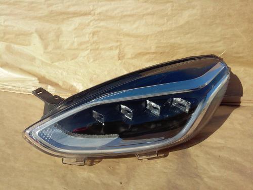

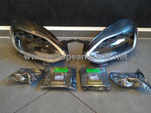

One place seems to sell those orginal ledlights:
Full led headlights
Full led headlights
That seems to be the most complete offer with the extra control modules but they do state they don't know exactly what is required to retrofit these so it's super likely this isn't the only set of items you will need. Either way, that offer has a hefty price tag...ouch. Think Autobeam might win with a £30 LED bulb 🙂
