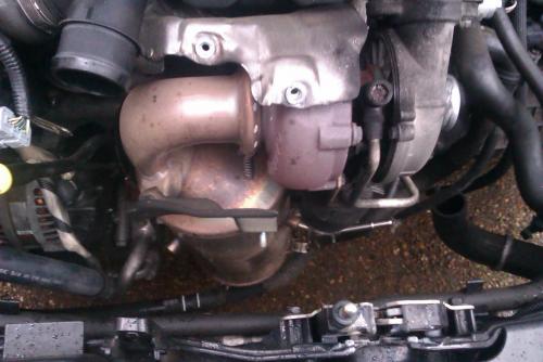

I'm pretty sure all of the 1.6 TDCi's have a DPF by 2010.  All 110bhp models had them from 2004, but the 90bhp models didn't have one until around 2009.
With hydraulic power steering I think that engine is actually from a PSA car rather than a Ford!  Can't imagine the 8v ever came with hydraulic PAS either so presumably it is the 16v version from a Picasso or 407 for example.  The DPF is the same shape though. :smile:
Hi, I have a 2005 (55 reg) 110 bhp which was made in late July 2005 which does not have a DPF i.e Euro 3. When I used to put in the Transport for London ULEZ website it was showing has Euro 4 but it was wrong.
Also 3 1/2 years ago mine went into Limp mode and was checked by two different mechanics who [plugged in their laptops ] both said DPF problems. I told the second one [ bosch diesel specialist ]  'that could be difficult due to not having one', he renewed the software and changed the fuel filter. No further problems.
