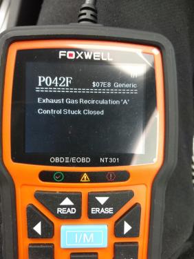

I also have not had any joy in getting any codes come up with the new hand held, but I did a dash board diagnostic and it did come up with D900 & E510. I have read that these dash codes are not very good is that correct?
D900 is DTC U1900, which is a rather common code that does not mean much on its own. Just a general communications error.
E510 is DTC U2510, which is a PATS (immobiliser) error, that the ECU & IC (dash) could not communicate the key code.
You did seem to have a PATS problem (no start, red light flashing) in the 1st post. They could both be quite old DTCs.
With a good code reader it should be possible to clear these codes and see if and when they return.
If the code reader you are using is Forscan with the ELM327, I am a bit surprised it is not reading these codes. It usually gets just about everything. Many generic handheld readers will only read the more basic engine codes.
If the ABS wheel sensors are misbehaving badly enough to cause problems, they will usually generate DTCs in the ABS unit. But generic readers will not get these. The code would identify the suspect wheel.
One possible cause of all these odd errors is voltage drops due to bad wiring or connectors, especially the heavy earth wire to the engine, or a dodgy battery or alternator. The ABS and EHPAS steering unit both take heavy and rapidly changing currents from the system when active.

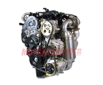

The DPF is just below the turbo, at the front of the engine. Hard to see clearly from above, it is hidden by the turbo heatshield and all the ducting. It has small pipes coming out of it, with small hoses attached. The best photo I could find is below, it is the vertical silver cylinder. I am not quite sure if the photo is the DV6 (your engine in a Mk2/2a 1.6TDCI) or the DV6c used in the Mk3 Focus, but the DPF location looks to be similar.
I'm pretty sure all of the 1.6 TDCi's have a DPF by 2010.  All 110bhp models had them from 2004, but the 90bhp models didn't have one until around 2009.
With hydraulic power steering I think that engine is actually from a PSA car rather than a Ford!  Can't imagine the 8v ever came with hydraulic PAS either so presumably it is the 16v version from a Picasso or 407 for example.  The DPF is the same shape though. :smile:
