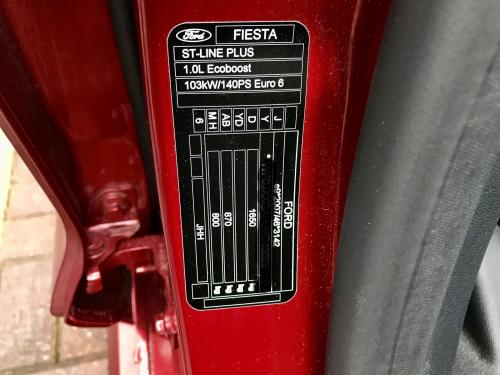

In addition to the above, check the sticker in the driver door pillar. This will give you the variant. If a 140, it will state Fiesta ST-Line (140) somewhere on that sticker which also displays the VIN code.

first thing I checked when I bought mine 😊
What makes it a 'plus' model out of interest?  Is it an ST Line X?
ST Line X
