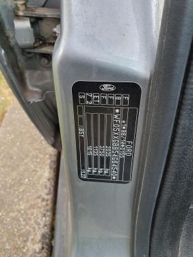

Is 1.27 the actual plate value for these?  You can check this yourself, the plate just inside the drivers door, the value should be in a small box at the bottom.  Seems a bit low to me but could be correct.  Since the MOT change last year, testers are now meant to use the plate value if one is present.  If there is no plate value on your car the limit would be 3.0 - so even then you'd only just scrape through!  I'd guess you have a boost leak somewhere, or a leaking EGR valve which is very common on these engines.  If it's neither of those, injectors are another common issue on these.
The brake pipe needs replacing of course.  Not sure what to say about the fuel rail, can you see an obvious place it's leaking?  May just need a nut tightening?

I have attached a photo.
Is this the label you are talking about?
Should I *not* deface the part that says 1.27 or should I *not* peel the label off all together?
I still believe even with the emissions the other parts would fail anyway and replacing the injectors could cost a lot of money.
Never deface that. It is largely irrelevant anyway as the VIN appears in a number of places so you’ll just make it look sketchy.

Well it looks like the 1.27 is correct, I am surprised about that considering they're non-DPF and every Mk3 and X Type with this engine blows clouds every time the driver accelerates... :laugh:

1.27 is the original spec, Ford print it on the VIN plate... :smile:  Though I'm guessing back in 2004 they never thought it would actually be used after production... :laugh:
As I see it, the limit the car had to achieve on the pre-20 May 2018 regulations was 3.00.  It now has to achieve 1.27, that's quite a change and makes me wonder if the plan was to try to remove older diesels by stealth - sneak in this change in the MOT regs.
So it the owner had known this before the MOT test was done he could have removed the whole sticker (carefully with a plastic scraper) then used some white spirit to remove the goo then polished the door post area so it looked like there never was one there. Of course an MOT tester would know there should be a sticker there, but if the owner says I have owned the car for 10 years and there has never been anything there, then the MOT tester has to use 3 as the limit instead of 1.27 doesn't he?
I don't think the diesel emission value is shown anywhere else on the car.
