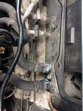

Went to replace heater control valve today and found this on outside of bulkhead / no heater control valve , wish I read my messages before I started 🙈(thanks dan62) hope this saves someone else the hassle as wipers were welded on , 2002 on tdci no heater control valve it seems
