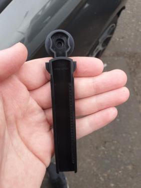

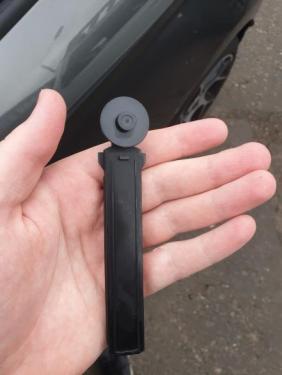

Today I opened my glove box and when I went to close it, the box kept jamming just before I could close it as if something was stuck in it. After going over to my passenger (left) seat I found a small plastic stick looking part with teeth on 1 side on the left side of the outside of the glove box? It seems like the only place it could have came from was behind the glove box somewhere and I am just wondering if anyone has came across a part like this before as I am baffled as to where it goes.

*EDIT* Code on the part appears to not be a part code and instead a plastic code.

That is glove box retainer. Slows lid movement when box is opened.
Round part goes to glovebox and stick part goes into "slit" that has small gear in it.
Thank you! Was stuck on if it was a part of the glove box itself or if it was something deeper behind is that got bumped when I opened the glove box. Thanks again!
