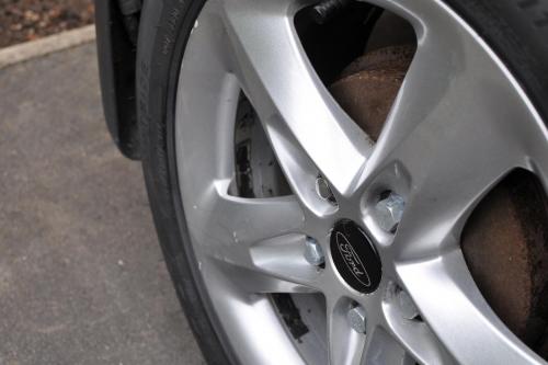

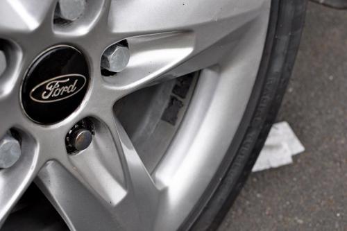

I bought a Chinese wheel brush from ebay to clean the inboard rims of my wheels. Did a marvellous job. Afterwards I noticed on all four wheels on the inboard side there are 60mm lengths of tape on the rim. Do these have a purpose. I googled it but found nothing, so thought you guys might know. They look lto have been there a long time.

They are the old sticky pads from previous wheel balancing weights.
They are not easy to remove either.
With the wheel off, I soaked them in white spirit (the only solvent I had to hand) and then sort of scraped them off with a piece of plastic so that the alloy was not marked.
Someone else may come along with a better method.
ScaniaPBman.
when I need to get sticky residue like that off I always use white spirit and an old credit card as the scraper
WD40 Is great for removing sticky residues.
Thanks guys that makes a lot of sense. I put new tyres on three months ago I can see the new weights.. I will wait for a warm day , and do a bit of scraping.

The smallest wheel weight is 5g and concentrated over about 5mm, the adhesive weighs so little and is spread over such a large area it won't make a difference. :smile:
White spirit is normally a great residue remover, but if that doesn't work, I always find that lighter fluid removes pretty much anything! (available in any '£1' shop...)

Two hours with a plastic scraper, and white spirit, they are now off.

If you haven't already I would wash them with some soapy water and rinse well to make sure the area is neutralised to avoid any damage to the wheel finish whether it be paint or powder coat.
To get the remains of the tape off, take the wheel off, get a heat gun and gently heat the tape, this will soften it, and you should be able to remove using a blunt plastic object, and then clean up with tar remover or citrus cleaner.
