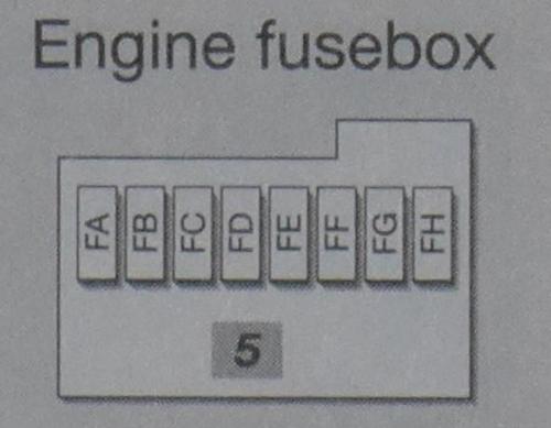

I found it! Thanks, pauls for point out engine fuse box location!
Which fuses? There 5 fuses.
Edited by Uncle Tommy
Photos
According to the Haynes manual (below), it is a 60A fuse, and they are A to H left to right.  So I think with A, B, and C not used, the right hand one of those five. If it is blown then you will need to check for a fault. H feeds Heated Front Screen via a relay, A/c F4, ABS F5 and F6, and Mirrors F8.  F7 probably not used.  Take care not to short circuit anything if you still have the battery connected,
Edited by Paulkp
