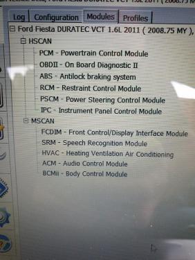

Hi can anyone help on this,all works A1 and loads on Laptop but when it says hit switch if i have one which i have i don't get anything else load.
Its the Tunnel Elm 237 and had it a few years,is there something im doing wrong on the setting as its got Auto ot Elm with switch,is it best to go to Elm with switch not Auto.
Go to switch not auto.
Got it to work at last,a stupid thing but nothing to do with setting,i have a longer lead what is male/female to make it easier but didnt work with that on so direct it worked fine and have all now.
