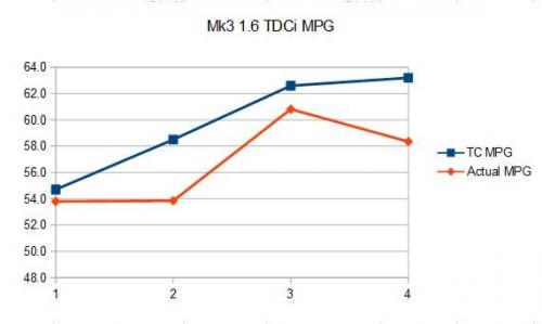

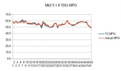

I was even sad enough to graph it recently...  :laugh:  The Mk3 preface trip computer was horrendously bad, 5mpg out half the time and always over read! :lol:  It only lasted 4 tanks/2400 miles though lol.  Yet another area in which the Mk2.5 was better! :biggrin:
