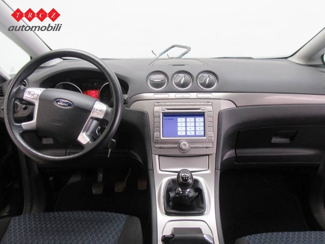

I'm gonna go look at it in a couple of days, but I see in images it has a multimedia system and for this kind I can't find anything on the internet. Someone know exactly what it is? Is it possible it might have handsfree? And are the AC controls included on this unit? Here's the image:

That's the Ford/Denso satnav that came with the pre-Facelift S-Maxes. The handsfree was a stand-alone option, and very basic (with phone specific cradles that are no longer available for current phones). There are no more map updates (but then I think Croatia was never covered anyway), and if things go wrong they go expensive quickly (as in similar to what you paid for the car) again. A/C controls are integrated, so to replace this you have to change the centrestack bezel and get the standalone A/C control. I would try to find a facelift S-Max, or one without the touchscreen system, where it is easier to replace with an aftermarket radio / satnav if necessary.
