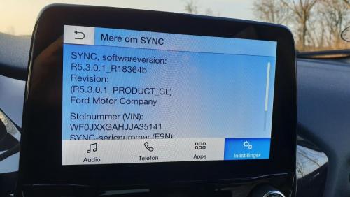

I've attached a picture below with my software version

On 8/26/2019 at 9:30 AM, Da9L said:
Hi everyone! First post here
I bought my self my first Ford back in February this year, a Ford Fiesta Mk8 1.0 Ecoboost with 140hp. And so far its been an okay experience. However i got one with a Sync version of 2.5 instead of 3. I did this because my only requirement was that it was able to run Android Auto, which it is. However I've noticed that when i do run with Android auto, no clock or signal is shown. At first i thouhgt that was something i needed to enable somewhere, but after further trying to fix it, I've come to the conclusion that this is because of my car, and not my Phone. If i plug it into my friends Focus mk3, which has Sync 3, the clock shows up just fine.
Heres a picture of what I'm talking about
The main problem is that, when I'm in Android Auto i can't even tell what time it is.
Is there a way for me to get Sync 3 in my Fiesta ? I figured it _should_ be possible somehow, since the hardware is most likely very capable of running it and possibly even the same as cars with Sync 3.
I spoke to my local dealer but they really do not know anything about this kind of stuff. They also told me that they wont even change the unit to a Sync 3 one if i paid for it, since Fords policy on this stuff is that once you have bought a car, it is tied to what it is bought with, so I'm a little unsure what to do now.
looks like revision 5 sync 3 to me where does it say 2.5?
That says SYNC 3.1
can't see anywhere it say 2.5!
It doesn’t!
21 hours ago, Rogue2 said:
It doesn’t!
That's what i thought!
