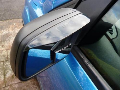

21 minutes ago, StephenFord said:
Yep, dead easy to get 'blind spot' detection - had these fitted to all my cars in the last 40 years, they're brilliant! 🤣
https://www.ebay.co.uk/itm/Pair-of-Summit-Car-Van-Convex-Blind-Spot-Mirror-Towing-Reversing-Blindspot/161599683377?epid=3017026791&hash=item25a0177b31:g:fs4AAOSw~y9ZAlvJ
My hatred for these is nearly as much as for the door protectors...  :lol:
Come on Tom, how can you hate them so, they're lovely, and very practical LOL
Practical maybe, but man are they ugly!  Would wind me up no end seeing that in the mirror constantly with a smaller image...like 'picture in picture' on the old TV monitor systems! :lol:   As you've probably guessed, they were another favourite of my Dad's...he really liked all that cheap tat stuck everywhere on the car but wouldn't let us kids place stickers anywhere in the house! :laugh:
