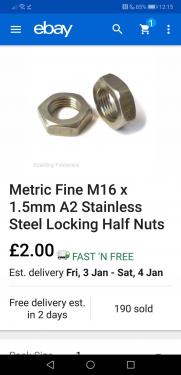

Nut M16X1.5mm
4704597
Just done a quick search on eBay, £2 for 1, but the genuine Ford nuts come as a pack of 5 for £14.99 😵

Nut M16X1.5mm
4704597
