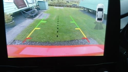

Yes, they radiate from the car image as shown below top right of the screen, changing colour as the beep becomes more frequent as you near an object.

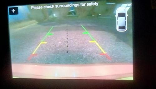

I ordered my car with sensors and camera, but due to a ***** up somewhere, it only came with the camera, the dealer fitted sensors about two weeks later, but wasn’t sure if it would show the picture of the little car in the screen, well it doesn’t, so if you fit sensors, it won’t show the car ,( as in the pics shown) it doesn’t bother me, but just be aware of that. btw, I got a cheque from ford for for not fitting the sensors, and the dealer extended the warranty for a further two years.

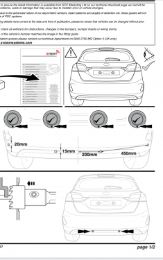

If your middle sensors are in the black rather than body coloured plastic on a mk8 I'm not surprised they don't work that well.  The Black plastic is much lower than it was on the mk7 Fiestas
This is where the xvision  sensors should fit on a mk8. And the sensors should be the angled type.
Don't know if it would affect operation, but those are quite a bit lower than my factory fit sensors, which are slightly above the bottom of the reflectors.
As Alan mentions above, the X-visions we had on my Mrs's Mk 7 were mounted higher up also, and worked pretty well.
Yeah mine are as iantt has shown.
Two in the bumper and two in the black plastic.
When looking at different cars, before I bought this one, I saw a few MK8s with the same x-vision placement so I'm sure it's how they are fitted by Ford dealers, as mine were.
As Eric says they are much lower than our factory fitted ones. Perhaps they have to be that low to get under the bumper bar. Perhaps they just need to be angled up more.
I wouldn't put it past just being a case of not having to remove the bumper.  The  locations are all pretty close to the edges in comparison to the factory fitted ones.

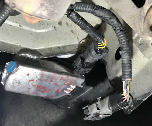

Seems there's plenty of second hand availability of the parking sensor looms and taking a look under the back bumper, on the drivers side I've located two spare plugs on the loom, see pic below
I'm hoping one of them is for the parking sensors, can anyone pls confirm? @Eric Bloodaxe maybe =o)

Just had a quick look for you but couldn't see the plugs you mention - the ST-L bodykit extends a fair way forward making access/vision difficult. Might be easier to spot on a Titanium or similar.
this is the connector for rear parking sensors
